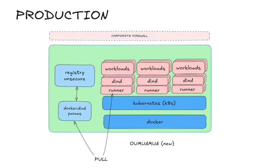

docker:dind (Docker-in-Docker) image. The key modification was configuring the Docker daemon inside this DIND image to trust and allow pulling from the local, unsecured registry. This typically involves adding the --insecure-registry <registry-host-ip>:<port> flag to the DIND daemon's startup parameters.docker:dind image for the runners it provisions.This setup allows the DIND service within each runner pod to pull images very quickly from the registry located on the same host machine.
Remaining Limitation (Hostname Resolution):
The only drawback with this approach is accessing the local registry from within the DIND container using a hostname. Modifying the /etc/hosts file inside the docker:dind container (either during build or runtime) proved problematic. Therefore, any references to the private registry within pipeline steps (e.g., in image: definitions or docker pull commands inside scripts) must use the K8s node's IP address and the registry's port (e.g., image: 192.168.1.100:5000/my-image:latest) instead of a hostname like my-local-registry:5000.
Architecture Diagram:
