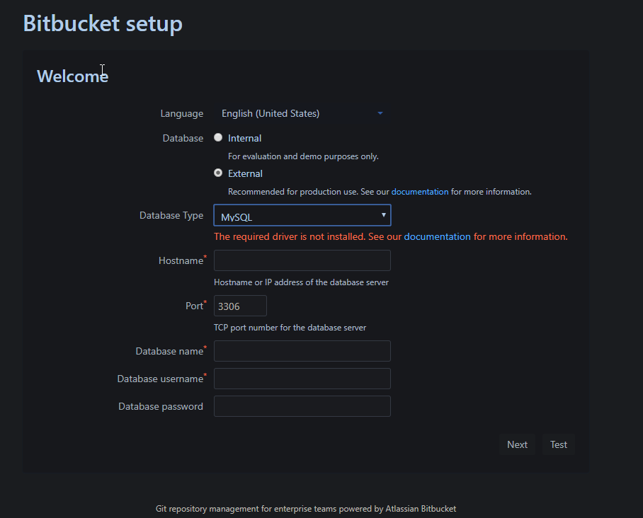

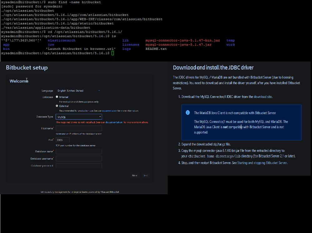

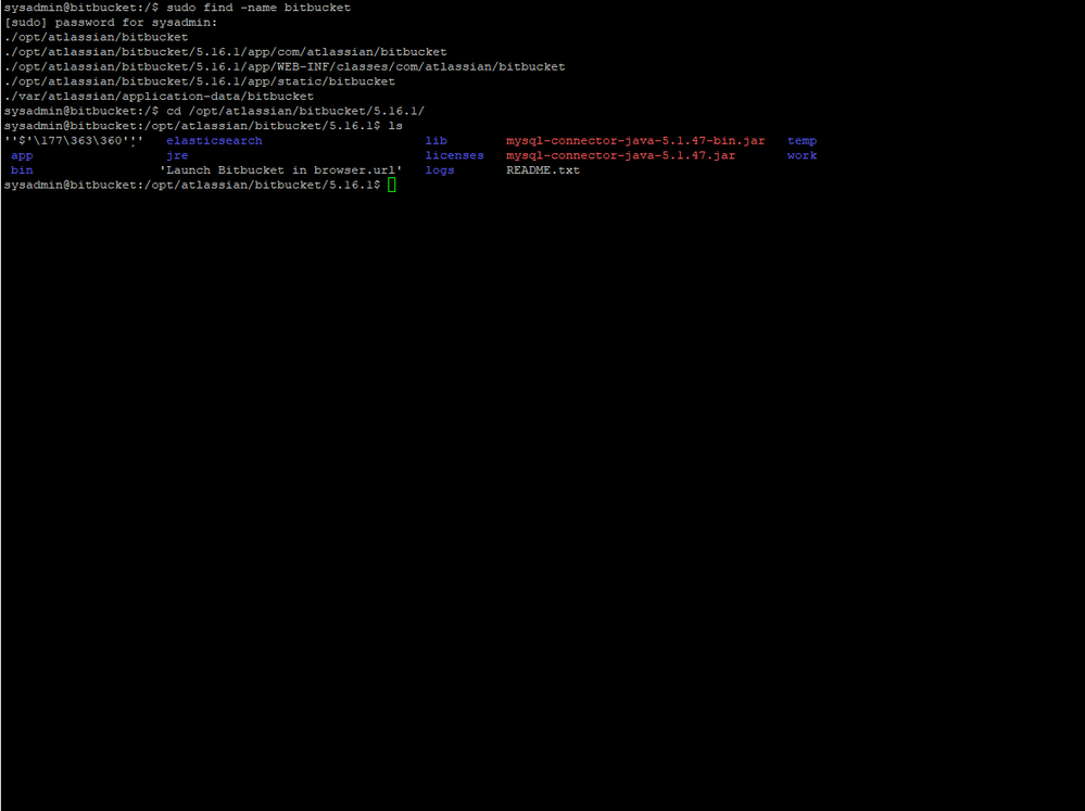

I'm trying to install the bitbucket "Self-Hosted" server though I can not as it gives me a "The required driver is not installed. See our documentation for more information." error. The MySQL connector is in the correct place based on the documentation though. I have rebooted and restarted the Bitbucket server, as well as try installing the .deb file provided at https://dev.mysql.com/downloads/connector/j/ for Ubuntu 18.04 with no luck. I tried updating to Bitbucket 6 and going from there since these screenshots were taken but the same errors have occurred.

As stated in step 3 of the last screenshot, the driver should be under the lib folder of your bitbucket home directory.
Then make sure the user running Bitbucket is the owner of the jar file.
Anthem Business Group
February 13, 2019
As per my first screenshot it is in /lib but I was not running it under the atlbitucket user. This has worked thank you!
