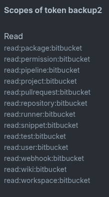

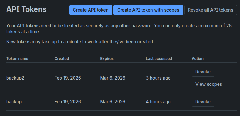

My API Token does not have any scope.
I also generated a second token with scoped privileges, granting all read permissions. But here it also does not work.

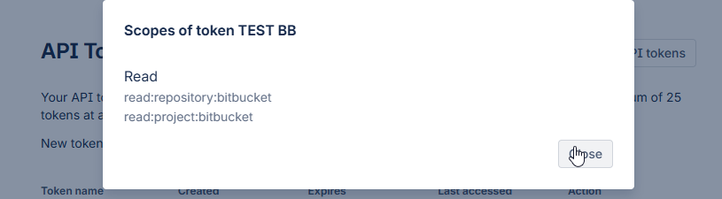

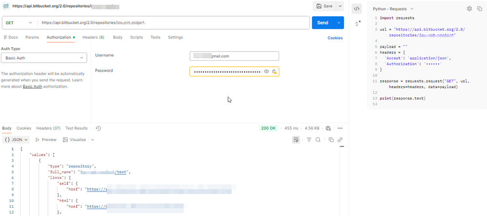

Strange. Checked on my test project, everything works.
I created token with scopes, used basic auth and token as password. I received list of repos

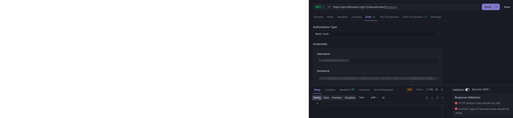

I try the same, but I do not have equal results, I still receive 401:
What else I can validate?

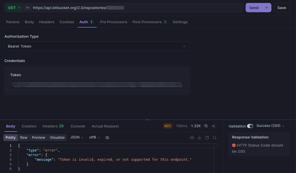

Not "Bearer". Use Basic Auth
Very fast oneliner to check:
curl -u "your_email@gmail.com:API_Token" "https://api.bitbucket.org/2.0/repositories/your_workspace"
Dunno, why same request is not working for you.
I tested both basic, and Bearer, you can see it on both different screens.
But it does not work.
