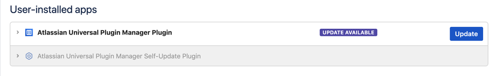

Jumail Mundekkat
July 18, 2019
Hi Ana,
Thanks for your help earlier and your reply.
I did already confirm which plugins were compatible and which ones were not, and attempted to to the update, which disabled all my plugins in the process.
The plugins I was trying to enable were ones that were compatible with the new version of Bitbucket Server I upgraded to, but I've gone ahead and removed all the plugins other than the universal plugin manager itself:
image.pngEven then, trying to update the universal plugin manager fails with the same stacktrace (except this time for the self-update plugin).
