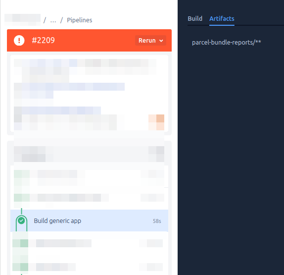

I have a pipeline step that looks as follows:
- step: &build-generic
name: Build generic app
script:
- npm install
- npm run build:generic
artifacts:
- dist/**
- parcel-bundle-reports/**
I just recently added the artifact for the parcel-bundle-reports folder and that broke later steps in the pipe because dist was no longer available as an artifact.
However, when I run this, I get only the last folder added as an artifact:
What's going on here? The documentation looks almost identical.

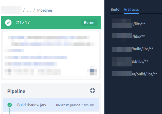

Update
We have other pipelines that do the same thing without issue:artifacts.png

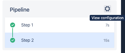

When you're viewing a Pipelines build, there's an icon with a cog image. If you hover it, you'll see the text "View configuration" like below:
If you select it, you'll see the yaml file used for this specific build. My first suggestion would be to select that for the build that failed, and double-check that - dist/** is indeed included in the artifacts definition for the step that should generate them.
