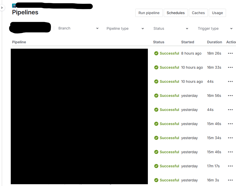

My current pipeline code works fine and has been working for maybe 3 months now. Every time a pull request is created or updated, it runs a "test build" on the source branch. However like I said in the original message, it takes about 20 minutes to do an entire build, although I do cache build successes so we don't build the same branch/commit combo twice. (See attached photo below.)image.png
When there's a normal flow of pipelines coming in, everything works fine. The issue was I attended a conference and our runner fell offline, so I had about 100 jobs to run when I came back from the conference. It would run the first couple successfully, then "fail" all of the remaining ones with the note I included in the original message. Is there like a "timeout" where Bitbucket automatically cancels pipelines if they've been sitting too long?
