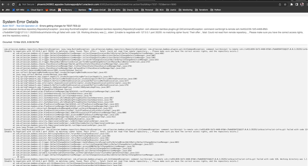

while cloning git repository in bamboo getting below error
com.atlassian.bamboo.repository.RepositoryException: java.lang.RuntimeException: com.atlassian.bamboo.repository.RepositoryException: com.atlassian.bamboo.plugins.git.GitCommandException: command /usr/bin/git ls-remote ssh://e452c039-1bf3-4468-8fb0-c7bdb8584722@127.0.0.1:35255/iotbca/infra/iot-infra.git failed with code 128. Working directory was [.]., stderr:
[Unable to negotiate with 127.0.0.1 port 35255: no matching cipher found. Their offer: , fatal: Could not read from remote repository., , Please make sure you have the correct access rights, and the repository exists.]
