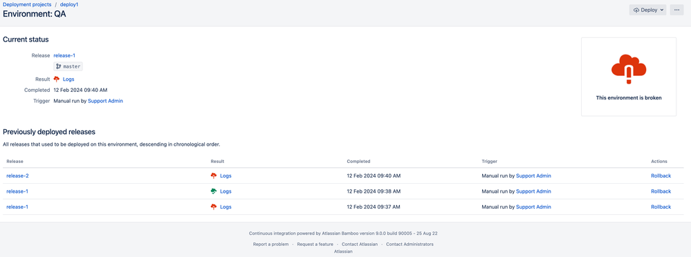

You can rollback the deployment to previous releases from the rollback option available under the deployment environment like below:
You can also rollback by deploying the Release that you want to rollback to and using the bamboo.deploy.rollback (true|false) Bamboo variable or BAMBOO_DEPLOY_ROLLBACK environment variable within your deployment scripts to detect the rollback case and execute different steps.
