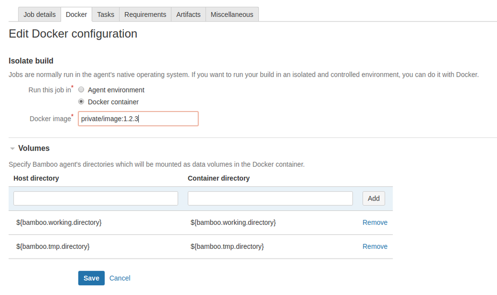

how can i configure Job -> Docker to authorize with my private docker registry?
i'm getting 403 when downloading private docker image e.g. private/docker-image:1.2.3
