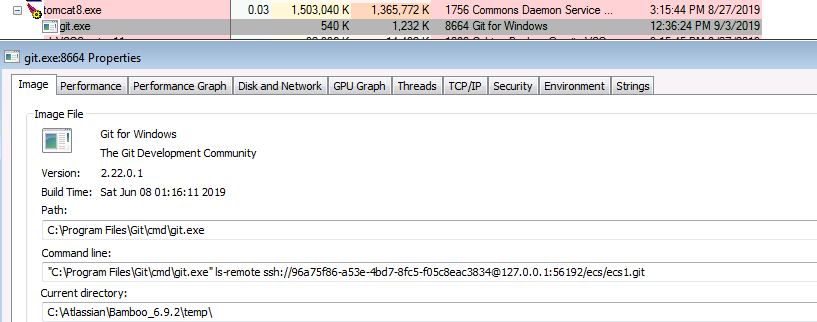

Following an update to the git repository the build for all branches of the repo get stuck 'checking out source code'.

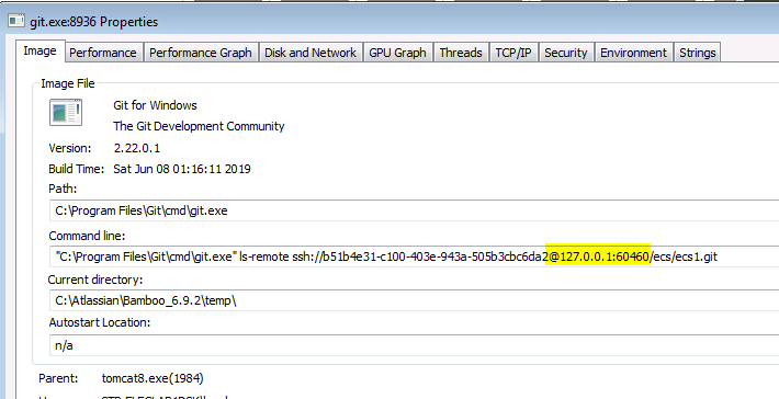

There is a stuck 'git.exe' process on the server attempting to run `git.exe ls-remote' on the address '127.0.0.1:60460'.
Our git repo is running on Bitbucket Server on a different server, not on localhost.
If this 'git.exe' process is killed, the build picks up and runs as normal. I can see multiple other 'git.exe' command running successfully.
I cannot find where this particular instance of the command is getting the localhost address from. I've checked all the application links, and recreated them. As well as re-saving the linked repository, multiple times.

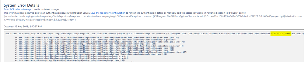

I also see system errors quite frequently from the same command.

When the plan trigger was set to 'Repository polling' I was getting constant "Unable to detect changes" errors (shown above).

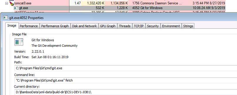

After clearing the cache and retriggering a build, the new build is stuck on a similar line as above, it looks like the git fetch command hung.
manually running git fetch appears successful, and the repo is up to date.
I was about to ask if I could disable the cacheing, but a quick search tells me that was a feature request from years ago that was never added.
If I stop the build via Bamboo, and rerun it via Bamboo it runs just fine.
