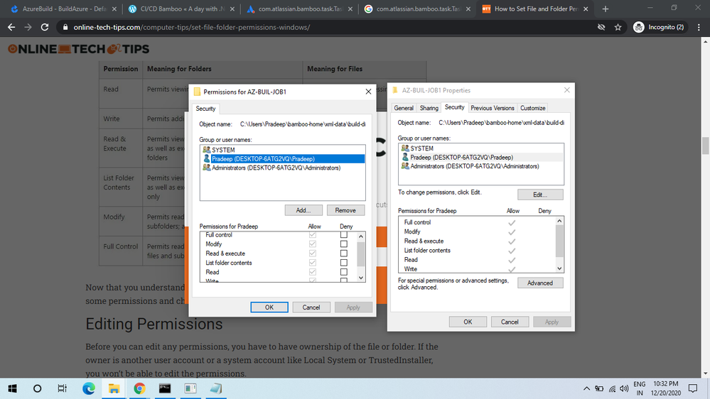

I am having space, i am not understanding how to resolve this. can you please explain me clearly.
You'll need to correct the permissions on the directories and files the build is trying to use.
Then you'll need to check the operating system logs - you need to find out why it is not letting the build agent have access to the files it is trying to create and update.
This is not a front-end Bamboo problem, you are going to need to fix whatever it is on the build server that is stopping the agent accessing the files.

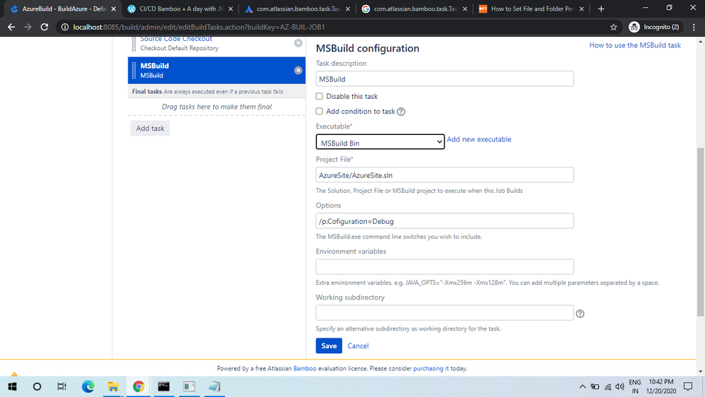

In MsBuild i given like this,is there any mistakes and settings avaialbe?
The MsBuild settings are not the issue. You need to look at why the Bamboo Agent is being denied access to the files by the operating system.
