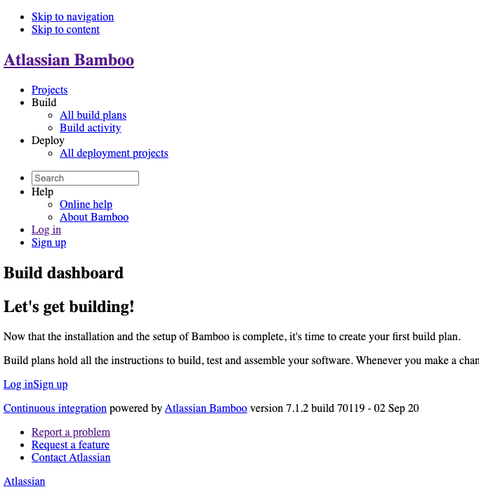

Hello, I have installed Bamboo 7.1.2 using MySQL on a Linux server (Ubuntu 18). The instance is secured behind nginx using SSL. I can access the site and have been able to set it up through the initial wizard.
However, the site is not loading its style and JS scripts, concretely these two: batch.css and batch.js.
Both are not found by the Chrome browser, which shows a 404 (not found) error when it tries to locate the above files from the following paths (BASE_URL should be replaced by the real domain):
BASE_URL/s/22339b840a686a652eda9cb945eaefe7-CDN/70119/1/ae711dd0dea2627fc013ff31d7536b2e/_/download/contextbatch/css/aui,atl.admin,-_super/batch.css?healthcheck-resources=true
BASE_URL/s/4f2a819378a916c3871918a0b64209dc-CDN/70119/1/ae711dd0dea2627fc013ff31d7536b2e/_/download/contextbatch/js/aui,atl.admin,-_super/batch.js?healthcheck-resources=true&locale=en
Without having the above properly loaded, I can barely do anything on the site (see attachment).
Could somebody help me solving this issue, please?

do you see the same error when bypassing the proxy server e.g over localhost`?

I need the proxy server running at all times, so I guess I can't test your suggestion. When I first run Bamboo without securing it behind nginx, I could not access it at all with the default url:
http://BASE_URL:8085
After I linked it with nginx, I had access to it.
Your comment has lead me to the following chat regarding nginx not serving static files: https://stackoverflow.com/a/23780906
Do you think this is the solution to the problem?
location ~* /bamboo/\.(js|jpg|png|css)$ {
    root path/to/bamboo-install/;
    expires 365d;

Update:
I have tried by adding to nginx:
    expires 365d;
But it does not fix the issue.
