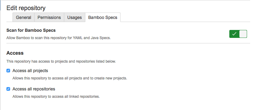

4) The bamboo-specs linked repo is not used by any build plan. The idea is this is a separate repository that is only used to host our entire bamboo configuration.
- The linked Repository was granted full access to All Projects and All Linked Repositories

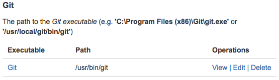

Also, what version of native Git are you running on the Bamboo Server and has it been added as a Server Capability in the Administration settings? Older version of native Git (such as 1.7.1) will cause issues.

Both git and maven are added as server capabilities ( running native git 2.8.2 on the bamboo server )
And the linked repository is configured to be a bamboo-specs repo
