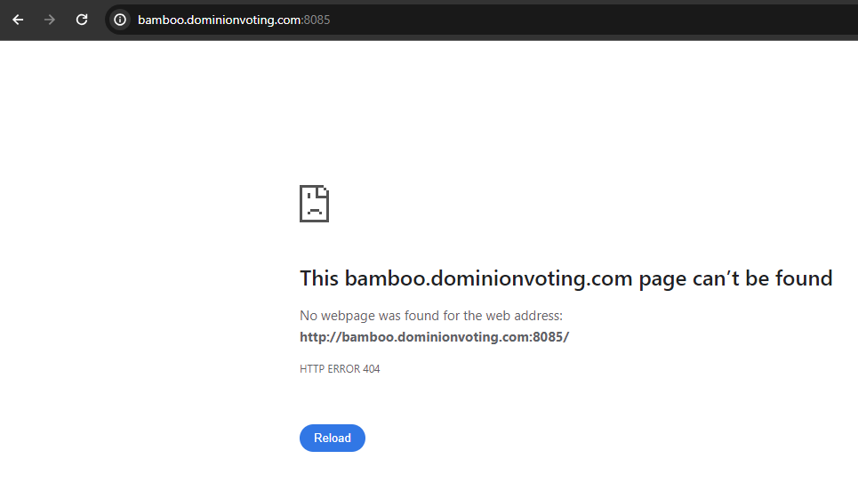

Andy Huang
March 5, 2024
Hi Jyothi, please see attached screenshot. I don't see proxy config in <Bamboo-Install-Directory>/conf/server.xml. I don't see any lines added to <Bamboo-Install-Directory>/logs/catalina.out file when access bamboo UI. The bamboo server isn't reachable from the internet. Currently there are only 2 localhost lines, there is no DNS config in /etc/hosts file. How do I generate a complete bamboo support zip? Thanks.screenshot.png
