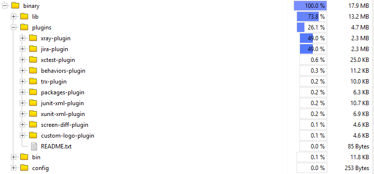

Nikola_Toshkov
August 13, 2024
Hi yes most of them are ~18mb, folders named  "binary-number" -> binary with a folder plugins with few .jar from pluings xray and jira and allure reports?
Allure Report
Configure Allure Reporting
in the config all are checked[\/]
Download if no executable present
Enable report custom logo
Build Allure for all builds by default
Shashank Kumar
August 13, 2024
Hello Nikola,
This is coming from the External plugin Installed in your Bamboo Instance, https://marketplace.atlassian.com/apps/1217177/allure-report-for-bamboo?tab=overview&hosting=datacenter.
Probably you'll need to check the settings for this plugin and check why the files are being generate in /tmp location and can it be changed.
Regards,
Shashank kumar
Nikola_Toshkov
August 13, 2024
A little digging turns out it has about 150k folders ~17mb containing plugins .jar not just allure, still looking around at the settings what is causing it :plugins.png
