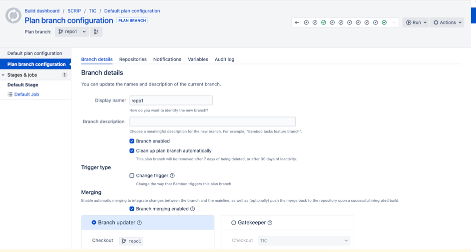

I did check this internally and feedback is that branch-override will override only the attributes for branches which you are able to change from GUI for a plan branches, see the below screen. Anything which gets tagged to the default plan configuration will not get changed via branch override.
For this you can probably use Specs branches and modify the individual specs file for each branch if you wish to have specific configuration for each branch but that will work after the branch is created.
I agree the documentation is not very clear about this, probably this can be improved a little
