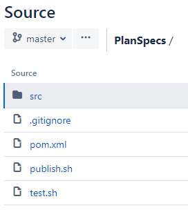

Here's a screenshot of what the project looks like:
Should "src" be named "bamboo-specs"? I created the project with the Maven Archetype the way the tutorial had me do.

Alexey Chystoprudov
April 23, 2019
All content of your repo root should be at bamboo-specs folder
/-bamboo-specs
|-src
| \java
|-pom.xml
Like Dov Frankel likes this

Alexey Chystoprudov
April 23, 2019
https://confluence.atlassian.com/bamboo/tutorial-bamboo-java-specs-stored-in-bitbucket-server-938641946.html
Note: You must create Bamboo Specs in the bamboo-specs directory, under the repository root.
