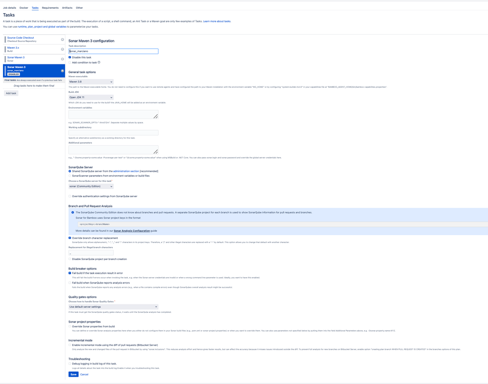

Hmm.. I'm not seeing any task field with "Choose a server for this task (required)". I'm mostly having default settings in the task:
And these settings are similar as task 1.

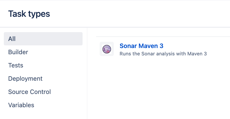

I forgot to mention I choose the "Sonar Maven 3" Task from the 'templates'.
