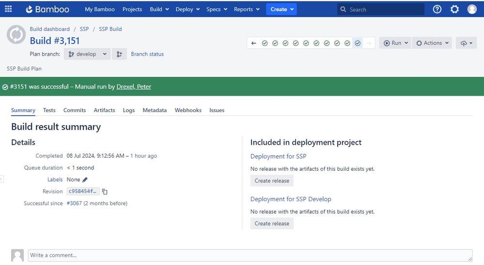

We have a number of build plans that are working (i.e., calling the scripts and commands that we configured). However, we have one plan that does nothing when you run it manually or when it detects a repository change and runs automatically. When you run it manually, it appears from the web interface to execute, but quickly ends with no indication of failure but there are no artifacts and no log. This plan used to perform as expected so I guess something in the configuration has changed, but I'm not sure what.

When I attempt a manual build from the Bamboo web interface for our develop branch, no commands are executed and the the status goes green within seconds. I do see these entries in the log. The referenced commit corresponds to develop.

If the log you're referring to is the one accessible via the logs tab in the web interface, there is none. It's as if the build doesn't think there is anything to do.

OK, I figured it out. Apologies to all for not realizing it sooner. It turns out the job within the plan was disabled. I only discovered this because I went to recreate the plan instead of cloning it and I noticed under the Job Details tab that it had been disabled. I'm not sure when/how/who disabled it, but once it was re-enabled, the plan executed as expected. Thanks for all the help.
