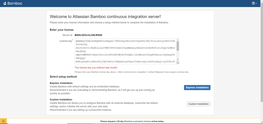

While creating new bamboo instance I can't add evolution licence.

Hi,
I am trying to create a new test bamboo instance and while attaching the evolution licence it says that
The license key you entered was invalid.

While I checked the logs I am getting an error like this.
2018-10-15 10:52:29,835 INFO [http-nio-8085-exec-24] [LicenseEditionPropertyTransformer] License type 'null' can not be resolved. This is a potentially corrupt license.
