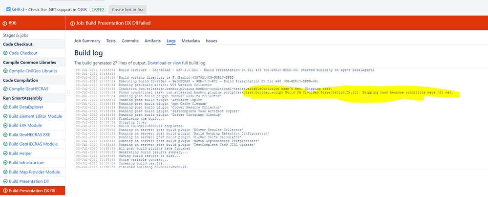

×I have a conditional task for which i have used a plan variable isRCBuild to trigger.
When isRCBuild=0 it should run otherwise no.
When the isRCBuild=1 the condition is not met but the whole builds stops, why is that? shouldn't it just be skipped??
If it's the only task then build fails because there were no tasks for execution. Add dummy Script task "echo hi" to avoid it
If it's only task then it should go to next job. I think this qualifies as a bug.
@Alexey Chystoprudov Do you think this should qualify as a bug?
For the workaround, i now check the bamboo variable from the script itself and EXIT if required. Bamboo conditional tasks are not that robust from my POV.
@Chitrarth Sahai , it's existing behaviour. When you create job without task Bamboo fails it as we decided it's not a good situation.
The same when all tasks are skipped, it means job had no executable tasks and its state is unknown.
Well then it would be nice if there was a conditional Job and not just conditional tasks :)
Right now the only way to get a conditional job, is to set the same condition on each task in the job, except a final dummy task that always runs. That seems like a bad way to have something change in the future, but forget to change it everywhere.
You cannot skip the default checkout task for a job. You need a workaround in order to not do this.
You cannot skip a job from running, you need to set conditions on every task inside that job, but then the job will fail so you need a workaround for this too.
You cannot set conditions on artifacts (unless I am missing something), so when the task that generates the artifact is skipped due to a condition, the job will fail if the artifact is required.
It doesn't make sense, do bamboo developers not use bamboo?
