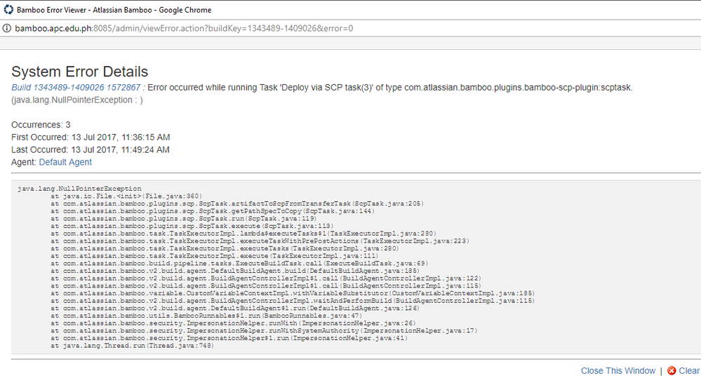

×I'm setting up my deployment plan and I'm using SCP task.. When I try to deploy, I get this error..
simple 13-Jul-2017 13:51:06 Build Deployment of 'release-1' on 'APCIS Production Environment' started building on agent Default Agent simple 13-Jul-2017 13:51:06 simple 13-Jul-2017 13:51:06 Build working directory is /var/atlassian/application/bamboo/xml-data/build-dir/1343489-1409026 simple 13-Jul-2017 13:51:06 Executing build Deployment of 'release-1' on 'APCIS Production Environment' simple 13-Jul-2017 13:51:06 Starting task 'Clean working directory task' of type 'com.atlassian.bamboo.plugins.bamboo-artifact-downloader-plugin:cleanWorkingDirectoryTask' simple 13-Jul-2017 13:51:06 Cleaning working directory '/var/atlassian/application/bamboo/xml-data/build-dir/1343489-1409026' simple 13-Jul-2017 13:51:06 Finished task 'Clean working directory task' with result: Success simple 13-Jul-2017 13:51:06 Starting task 'Source Code Checkout' of type 'com.atlassian.bamboo.plugins.vcs:task.vcs.checkout' simple 13-Jul-2017 13:51:06 Build always requires a clean checkout simple 13-Jul-2017 13:51:06 Cleaning build directory '/var/atlassian/application/bamboo/xml-data/build-dir/1343489-1409026/apcis' simple 13-Jul-2017 13:51:06 Updating source code to the latest revision simple 13-Jul-2017 13:51:07 Git: Updating references simple 13-Jul-2017 13:51:07 Git: simple 13-Jul-2017 13:51:07 Fetching '+refs/heads/master:refs/heads/master' from 'ssh://git@bitbucket.apc.edu.ph:7999/apcdp/apcis-cobalt-codebase.git'. simple 13-Jul-2017 13:51:07 Checking out revision 0b2533857de137c6cc28ce863b1e69d96223e4e4. simple 13-Jul-2017 13:51:07 Creating local git repository in '/var/atlassian/application/bamboo/xml-data/build-dir/1343489-1409026/apcis/.git'. simple 13-Jul-2017 13:51:08 Updated source code to revision: 0b2533857de137c6cc28ce863b1e69d96223e4e4 simple 13-Jul-2017 13:51:08 Finished task 'Source Code Checkout' with result: Success simple 13-Jul-2017 13:51:08 Starting task 'Download release contents' of type 'com.atlassian.bamboo.plugins.bamboo-artifact-downloader-plugin:artifactdownloadertask' simple 13-Jul-2017 13:51:08 Finished task 'Download release contents' with result: Success simple 13-Jul-2017 13:51:08 Starting task 'Deploy via SCP task' of type 'com.atlassian.bamboo.plugins.bamboo-scp-plugin:scptask' error 13-Jul-2017 13:51:08 Error occurred while running Task 'Deploy via SCP task(3)' of type com.atlassian.bamboo.plugins.bamboo-scp-plugin:scptask. error 13-Jul-2017 13:51:08 java.lang.NullPointerException error 13-Jul-2017 13:51:08 at java.io.File.<init>(File.java:360) error 13-Jul-2017 13:51:08 at com.atlassian.bamboo.plugins.scp.ScpTask.artifactToScpFromTransferTask(ScpTask.java:205) error 13-Jul-2017 13:51:08 at com.atlassian.bamboo.plugins.scp.ScpTask.getPathSpecToCopy(ScpTask.java:144) error 13-Jul-2017 13:51:08 at com.atlassian.bamboo.plugins.scp.ScpTask.run(ScpTask.java:119) error 13-Jul-2017 13:51:08 at com.atlassian.bamboo.plugins.scp.ScpTask.execute(ScpTask.java:113) error 13-Jul-2017 13:51:08 at com.atlassian.bamboo.task.TaskExecutorImpl.lambda$executeTasks$1(TaskExecutorImpl.java:280) error 13-Jul-2017 13:51:08 at com.atlassian.bamboo.task.TaskExecutorImpl.executeTaskWithPrePostActions(TaskExecutorImpl.java:223) error 13-Jul-2017 13:51:08 at com.atlassian.bamboo.task.TaskExecutorImpl.executeTasks(TaskExecutorImpl.java:280) error 13-Jul-2017 13:51:08 at com.atlassian.bamboo.task.TaskExecutorImpl.execute(TaskExecutorImpl.java:118) error 13-Jul-2017 13:51:08 at com.atlassian.bamboo.build.pipeline.tasks.ExecuteBuildTask.call(ExecuteBuildTask.java:69) error 13-Jul-2017 13:51:08 at com.atlassian.bamboo.v2.build.agent.DefaultBuildAgent.build(DefaultBuildAgent.java:185) error 13-Jul-2017 13:51:08 at com.atlassian.bamboo.v2.build.agent.BuildAgentControllerImpl$1.call(BuildAgentControllerImpl.java:122) error 13-Jul-2017 13:51:08 at com.atlassian.bamboo.v2.build.agent.BuildAgentControllerImpl$1.call(BuildAgentControllerImpl.java:115) error 13-Jul-2017 13:51:08 at com.atlassian.bamboo.variable.CustomVariableContextImpl.withVariableSubstitutor(CustomVariableContextImpl.java:185) error 13-Jul-2017 13:51:08 at com.atlassian.bamboo.v2.build.agent.BuildAgentControllerImpl.waitAndPerformBuild(BuildAgentControllerImpl.java:115) error 13-Jul-2017 13:51:08 at com.atlassian.bamboo.v2.build.agent.DefaultBuildAgent$1.run(DefaultBuildAgent.java:126) error 13-Jul-2017 13:51:08 at com.atlassian.bamboo.utils.BambooRunnables$1.run(BambooRunnables.java:47) error 13-Jul-2017 13:51:08 at com.atlassian.bamboo.security.ImpersonationHelper.runWith(ImpersonationHelper.java:26) error 13-Jul-2017 13:51:08 at com.atlassian.bamboo.security.ImpersonationHelper.runWithSystemAuthority(ImpersonationHelper.java:17) error 13-Jul-2017 13:51:08 at com.atlassian.bamboo.security.ImpersonationHelper$1.run(ImpersonationHelper.java:41) error 13-Jul-2017 13:51:08 at java.lang.Thread.run(Thread.java:748) simple 13-Jul-2017 13:51:08 Finalising the build... simple 13-Jul-2017 13:51:08 Stopping timer. simple 13-Jul-2017 13:51:08 Build 1343489-1409026-1572870 completed. simple 13-Jul-2017 13:51:08 Finished processing deployment result Deployment of 'release-1' on 'APCIS Production Environment'

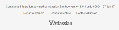

what version of Bamboo do you have?
It seemed to work now.. I changed the Artifact field to Local Files..
