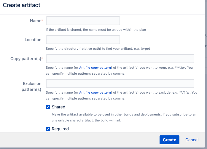

Can you go to the Job where you have defined this artifact and check it's definition and see if everything is correct, refer the below screen to check the parameters.

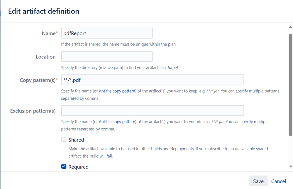

As mentioned I made these settings, I did not get any error in log but at artifact it is not showing any pdf. Can you send entire setting to be done related to artifact.
Hey Swati,
You've not specified a location within your Build directory where your Artifact would be located, this is a relative path inside your Build directory, this needs to be mentioned under location field in the above attachment.
If you open your Build directory for the build which failed, where are you able to see the PDF files? can you paste the location here?
Read Bamboo artifact definition syntax examples for more details.

Hi Shashank,
Thanks for your input, it worked. But issue is at particular location there are multiple pdf getting generated with timestamp pattern. I want it should get latest generated pdf and download it on artifact.

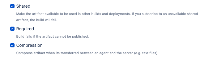

Hello Swati,
Artifact will only be displayed in the Summary section if while defining the artifact you have selected it to be shared. See below
It worked. But without checking shared checkbox it had worked on Bamboo server+ remote agent. I was able to generate PDF report on both summary and Artifact section. Why similar configurations did not work for Data center? Why it worked after we checked Shared checkbox?
