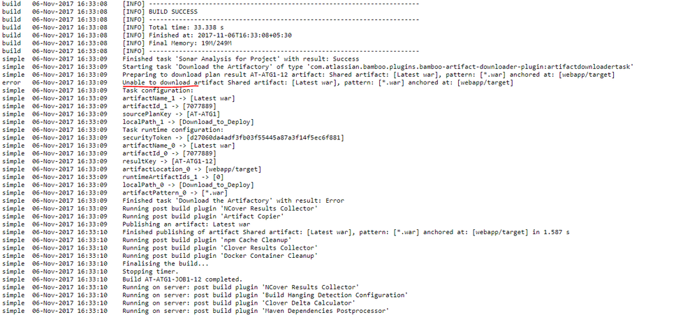

Shashank Singh
November 6, 2017

Unable to download artifact Shared artifact: [Script_art], pattern: [**/*] anchored at: [.]
