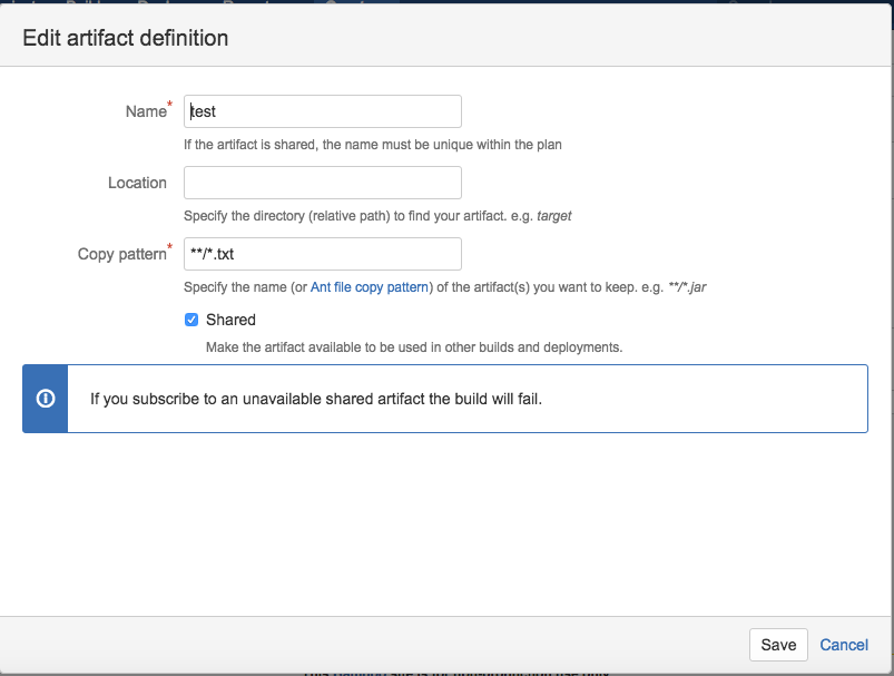

Below is an example:
Build Log:
simple 16-Jan-2018 00:51:11 Running post build plugin 'NCover Results Collector'
simple 16-Jan-2018 00:51:11 Running post build plugin 'Artifact Copier'
simple 16-Jan-2018 00:51:11 Publishing an artifact: test
simple 16-Jan-2018 00:51:11 Finished publishing of artifact Shared artifact: [test], pattern: [**/*.txt] in 6.205 ms
Deployment Log:
16-Jan-2018 00:53:33 Starting task 'Artifact download' of type 'com.atlassian.bamboo.plugins.bamboo-artifact-downloader-plugin:artifactdownloadertask'
16-Jan-2018 00:53:33 Preparing to download plan result ATP-ATA-47 artifact: Shared artifact: [test], pattern: [**/*.txt]
16-Jan-2018 00:53:33 Artifact [test] downloaded successfully in 6.315 ms to working directory
Screenshot:
Hope this will help.
Thanks,
Robhit

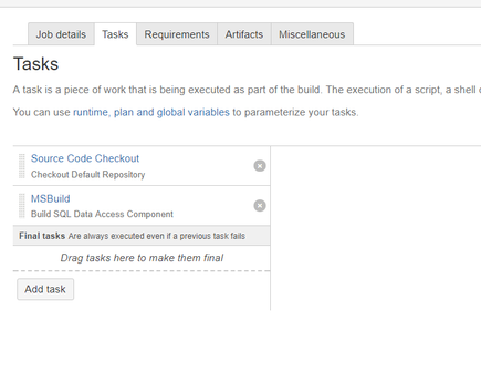

My Build Plan - 1:

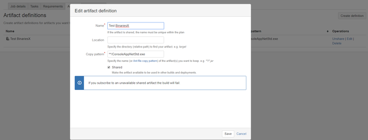

Build-1.pngMy Build plan - shared artifact:

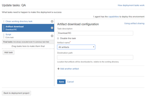

My Deployment Task Artifact download (in the Artifact name I can see "Test BinariesX" artifact which was shared:
