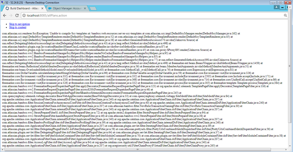

Hi
For last 15 hrs we are keep getting attached error message.Stopped and started bamboo service but no success. Can someone assist unable to start bamboo_Oct27.PNG

Hi Manish,
This can occur  when the Shared Access Layer (SAL) is not being enabled due to a timeout during startup.
Can you try the solution outlined in the following article:
Unable to compile Soy template in plugin module

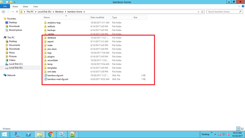

2) Per step 4,
And then, clean the cache by removing the directories below BAMBOO_HOME/caches.
 This will remove cache files only. It will not permanently remove any plugins. These directories will be recreated during the next Bamboo startup
can you pls confirm if I need to delete all folders which are listed below bamboo_home(D:\Bamboo\bamboo-home). As this steps asks to delete these folders hence I want to double check. I have attached an screenshot so that you can see and confirm if all folders listed below D:\Bamboo\bamboo-home\caches folder needs to be deleted.

regarding your second question;
do NOT delete the folders highlighted in your screenshot.  Navigate into the bamboo-home/caches/ folder.  Then delete the contents within there.
