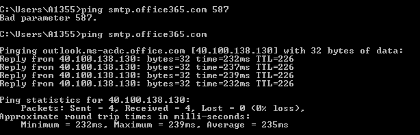

Manish Sharma
November 17, 2017
Hi Robhit
Thanks for your reply.
Tried running a ping command on our AWS server and got successfully message.
ping smtp.office.365.com 587  >> It threw error that 587 is bad parameter
ping smtp.office.365.com 587  >> it successfully pinged.
Pls suggest

robhit
November 17, 2017
Hi Manish,
There is a difference between Ping and telnet.
In short:
Ping: check connection (knock on the door of the remote server).
Telnet: gives access to the remote system if it is running telnet daemon.
And while using port 587 ping throws the error because it does not support that parameter.
Try executing the telnet command which I shared earlier. This will test the connectivity between your bamboo machine and the SMTP server if the port 587 which you are using is correct or open or not

Manish Sharma
November 17, 2017
Hi Robhit
Unfortunately I am not unable to use Telnet as its not configured. However, I am reaching out to my server team to see if this port in question ( 587) is blocked or not. Thanks

Manish Sharma
November 17, 2017
Hi Robhit, With help of our IT team we were able to open port 587 and now mails are getting triggered. Thank you so much for suggesting this approach. You may pls go ahead and close this incident and send me survey link if possible.
