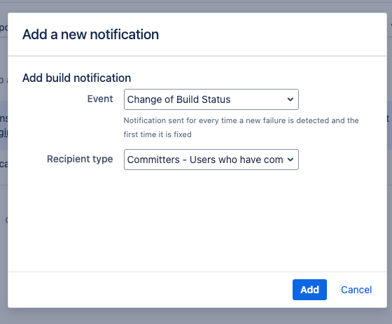

On the child plan if you set the below notification, won't it work ?
As I understand the child plan fails because of commit done by some user which triggered the main plan but same changes caused failure of the child plan.
Still child plan should be able to notify the original committers as those commits are causing failures.
Regards,
Shashank Kumar

We have set up the Child Plan to send an email notification when its build fails, specifically to the "Committers - Users who have committed to the build."
Our main question is: In the scenario described above (Child Plan fails due to a Parent Plan code change, with no new commits to the Child Plan's own code), will Bamboo's "Committers" notification correctly email the person who committed the change to the Parent Plan's code?
