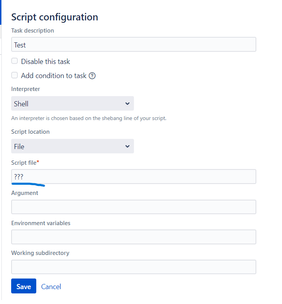

I am new to Bamboo and Bitbucket, and new to programming world. I have already created my code in Bitbucket and linked it to my Bamboo project in the linked repository section. I would like to run this code using a script task in Bamboo, but I am unsure about the linked repository path in Bamboo. How can I locate the linked repository path?

The path for the script should be either relative to the repository root of the plan, or absolute.
https://confluence.atlassian.com/bamboo/script-289277046.html
This location is known as the working directory. This is where Bamboo temporarily puts the checked-out files it's building.
For Bamboo8 and above - <BAMBOO_HOME>/local-working-dir/<JOB_KEY>

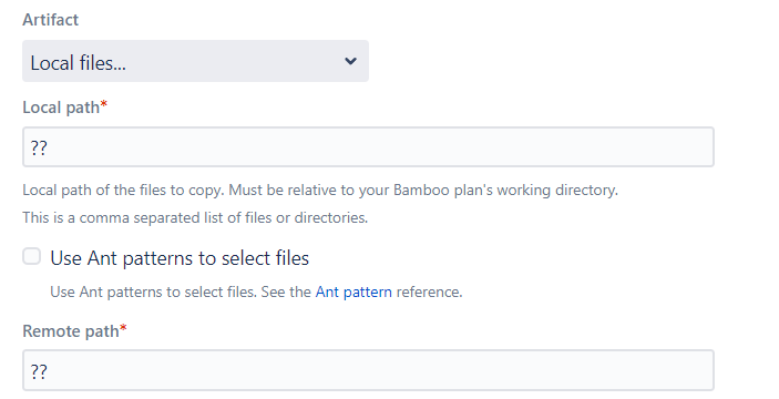

You can use the Bamboo SCP task to upload files from Bamboo directly to a remote server as part of a Bamboo job. The SCP task is able to copy multiple files and preserves the directory structure for the copied files.
More details of the task here :- https://confluence.atlassian.com/bamboo/using-the-scp-task-in-bamboo-305759795.html

1. I'm trying to use the SCP Task. For example, if my linked bitbucket repository name is TestHelloWorld, and I want to send my helloworld.txt or any file in the repository, how should I specify it in the local path or remote path?
2. I'm using Bamboo web. As I'm browsing the internet, it seems that the SCP Task requires artifacts to send. How do I produce artifacts, and which Bamboo task can produce them?
