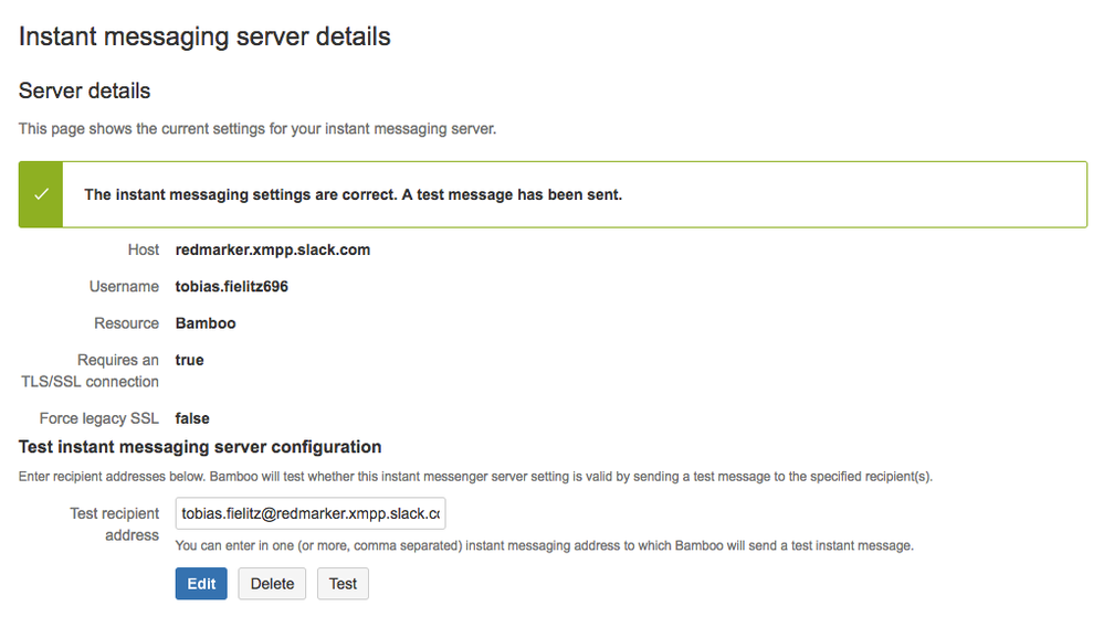

1. IM Server Setup (works)
I have created a new user in Slack called: "bamboo" (otherwise everyone would get messages from me). The credentials I have added under BAMBOO ADMINISTRATION - IM Server. Adding my xmpp address (tobias.fielitz@redmarker.xmpp.slack.com) in the "Test recipient address" field successfully sends a message from the Slack bamboo user to me saying "Your instant messaging server settings are correctly set up." So that works, great! I have added my xmpp address (tobias.fielitz@redmarker.xmpp.slack.com) under BAMBOO ADMINISTRATION - User management - <edit my user> - IM.

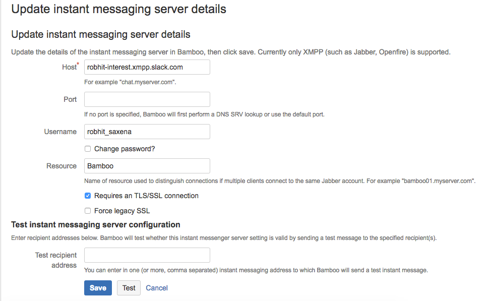

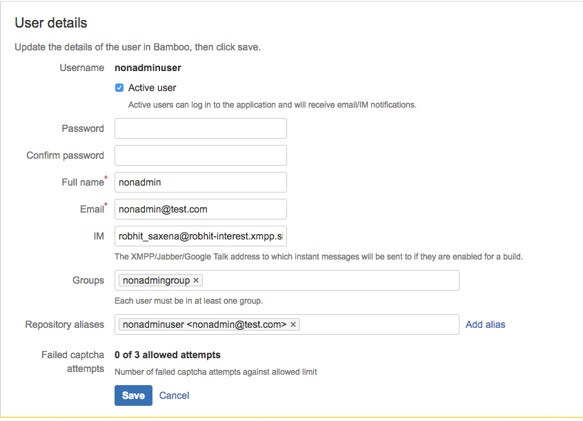

Do your settings look like this:
Do you see any difference here?
Screen Shot 0029-11-24 at 11.51.16 AM.pngScreen Shot 0029-11-24 at 11.50.07 AM.pngScreen Shot 0029-11-24 at 11.49.04 AM.png

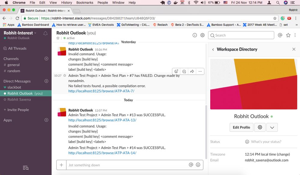

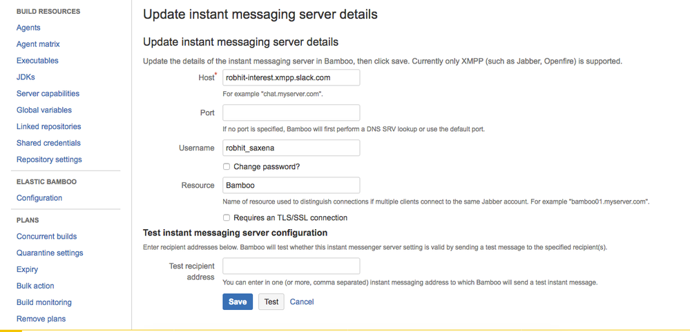

Hi @[deleted],
Sorry, I just realized that while configuring IM server you have to uncheck the "Requires an TLS/SSL connection". Then it will work.

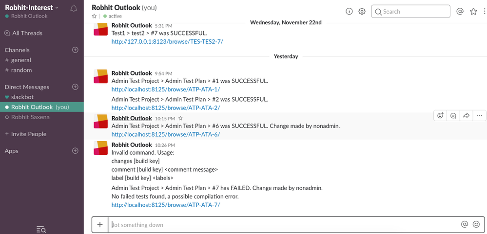

I have just tested it:
Screen Shot 0029-11-24 at 12.12.26 PM.pngScreen Shot 0029-11-24 at 12.11.12 PM.png

1. I have tested that the IM Server Setup works.

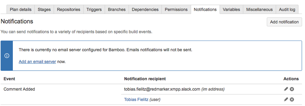

2. Even when setting my xmpp address directly under notifications it does not work.

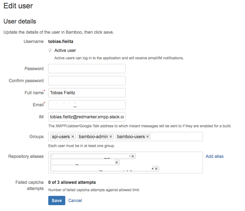

Screen Shot 2017-11-24 at 4.30.12 pm.pngHere is my user:
