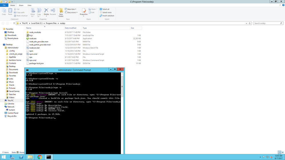

Thanks for the response.  I ran 'npm install' in command prompt under the folder that has nodejs.exe.  I've attached an image of what it displayed.  It looks like it ran, but gave an unable to find package.json message, along with a few othersnpminstall.png

Ok, I was able to run npm install and the npm run testci command successfully from the command line itself.  I can create a batch file that runs 'start cmd' and 'npm run testci' as a script task as well.  It looks like it's doing everything it's supposed to in the log, but the build never finishes.
As for setting a specific npm task in bamboo, I still get the same error as I listed initially, even if I set the sub directory to the build directory containing package.json.
