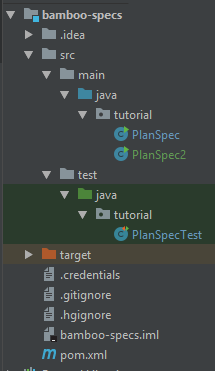

Thanks so much for the information. This really helps out a lot. Still waiting for our IT to update the proxy setting but do want to go ahead and start getting the file structure going. Do the files have to start with PlanSpec? Want something more meaningful than 2, 3, etc. Thinking (if PlanSpec is required) PlanSpec_description-here.java.
Here is what I have.
Do I need the .credentials file or is just for running locally? The plan I d/l from Bamboo does have a PlanPermissions section but not sure where this comes into play.

Is there anything special about the name PlanSpec.java? Thinking about keeping with names along the lines of PlanSpec_descript_name.java
Yes, it is possible to keep a descriptive name of your preference as I mentioned in my previous comment.
