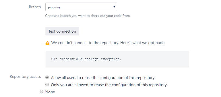

I am not able connect github from bamboo. Installed lastest version

I am able to pull the same repository from the Jenkins.. For some reason bamboo is not pulling my repository from the Bamboo..
Here is the public repository URL:
https://github.com/kaviproject/DEVOPS_Application_BAMBOOTest1.git

Are you able to test other repositories or users? Also, does your git works correctly locally? Can you double check if your git configuration is done mannerly? You can verify it under Bamboo administration > Server capabilities.

Thank you .. I tried git with username/password and none also ..NO LUCK
I provided remote git URL and same error..
 ERROR LOGS:
2019-05-24 11:27:15,487 INFO [http-nio-8085-exec-3] [AccessLogFilter] kavi GET http://localhost:8085/chain/admin/config/editRepository.action?planKey=DEV-DEV&repositoryId=851972&decorator=nothing&confirm=true&_=1558711632783 326481kb
2019-05-24 11:27:20,705 INFO [9-BAM::PlanExec:pool-15-thread-4] [DefaultErrorHandler] Recording an error: Unable to detect changes : DEV-DEV : : Git credentials storage exception.
2019-05-24 11:27:20,976 INFO [http-nio-8085-exec-11] [AccessLogFilter] kavi GET http://localhost:8085/chain/admin/config/viewChainRepositorySelectors.action?planKey=DEV-DEV&returnUrl=%2Fchain%2Fadmin%2Fconfig%2FeditChainRepository.action%3FbuildKey%3DDEV-DEV&decorator=nothing&confirm=true&_=1558711632785 291592kb
2019-05-24 11:27:23,841 INFO [http-nio-8085-exec-17] [AccessLogFilter] kavi GET http://localhost:8085/chain/admin/config/addRepository.action?planKey=DEV-DEV&selectedRepository=com.atlassian.bamboo.plugins.atlassian-bamboo-plugin-git:gitv2&decorator=nothing&confirm=true&_=1558711632786 286600kb
2019-05-24 11:27:51,998 INFO [http-nio-8085-exec-19] [AccessLogFilter] kavi PUT http://localhost:8085/rest/api/latest/repository/testConnection 516903kb
2019-05-24 11:27:52,035 INFO [http-nio-8085-exec-19] [RepositoryResource] Testing connection to repository (type: Git, location: https://github.com/kaviproject/DEVOPS_Application_BAMBOOTest1.git)
2019-05-24 11:27:52,043 INFO [http-nio-8085-exec-19] [RepositoryResource] Failed to connect to repository (type: Git, location: https://github.com/kaviproject/DEVOPS_Application_BAMBOOTest1.git, time: 7.938 ms, errors: [Git credentials storage exception.])
2019-05-24 11:27:53,853 INFO [http-nio-8085-exec-20] [AccessLogFilter] kavi POST http://localhost:8085/rest/analytics/1.0/publish/bulk 515327kb
Bamboo Server Edition

Thank you for the response..
ERROR
 2019-05-24 10:45:27,046 INFO [http-nio-8085-exec-3] [AccessLogFilter] kavi PUT http://localhost:8085/rest/api/latest/repository/testConnection 541503kb
2019-05-24 10:45:27,050 INFO [http-nio-8085-exec-3] [RepositoryResource] Testing connection to repository (type: GitHub repository, location: https://github.com/kaviproject/DEVOPS_Application_BAMBOOTest1.git)
2019-05-24 10:45:27,065 INFO [http-nio-8085-exec-3] [RepositoryResource] Failed to connect to repository (type: GitHub repository, location:
https://github.com/kaviproject/DEVOPS_Application_BAMBOOTest1.git, time: 14.42 ms, errors: [Git credentials storage exception.])
This is public repository.
I am not able to connect through my GItHUB username/password credentials .. I tried connect through GIt still did not worked. Can you please help for cloning repository issue.. I installed latest version bamboo. Please let me know if you need more information
