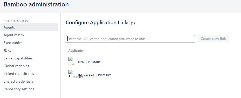

Hi Community,
I have migrated Bamboo to a new server. Actually, I only copied the home directory data and server.xml file and downloaded the bamboo.tar.gz file from the Atlassian website. I replaced the server.xml file and added the home directory path. Started Bamboo. Everything looks fine except icons are missing from the app link tab. When I right-clicked to inspect the page found out it's still showing the old server's URL (http://bamboo-server:8085) the new URL is https://bamboo-production.server:443, though that server is shutdown. I tested with multiple browsers. Is there anything else I need to copy to the new server? or how can fix this issue? Here is the class code for the app link that I copied from inspect page.
<img class="applinks-icon" src="http://bamboo-server:8085/s/70216/1/6.0.12/_/download/resources/com.atlassian.applinks.applinks-plugin:applinks-images/images/config/logos/128x128/128bitbucket.png" alt="Bitbucket" width="20" height="20">

Hello @Shah Baloch
Please update the Server URL:
  • Bamboo Administration >> General Configuration >> Base URL
You need to restart Bamboo after that change.
Also, make sure that the address reported on "Broker client URL" is reachable by the Agents.
