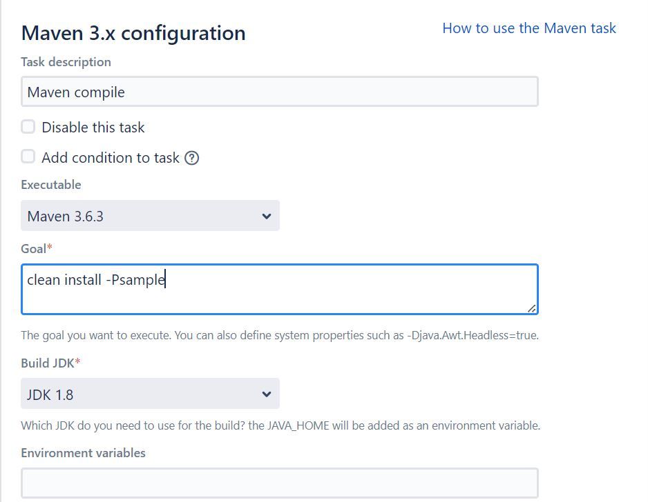

I have already configured job with maven command as "clean install -Psample"  (sample is my profile name in pom.xml as shown below) . But I started running the build it is giving issue as  " Non-readable POM /appl/bamboo-agent/xml-data/build-dir/project/pom.xml (No such file or directory)  The build could not read the project [Help 1]"
1)  How to configure bamboo job to generate maven build ?
2) How to run build with sample profile as shown below ?
3) Can we run "clean install" only to generate bamboo build ?
To run your Maven build with a specific profile, such as the "sample" profile you mentioned, you would include the profile in the "Goal" field of your Maven task configuration as you did:
  • In the "Goal" field, append -Psample to your existing command, making it clean install -Psample.
