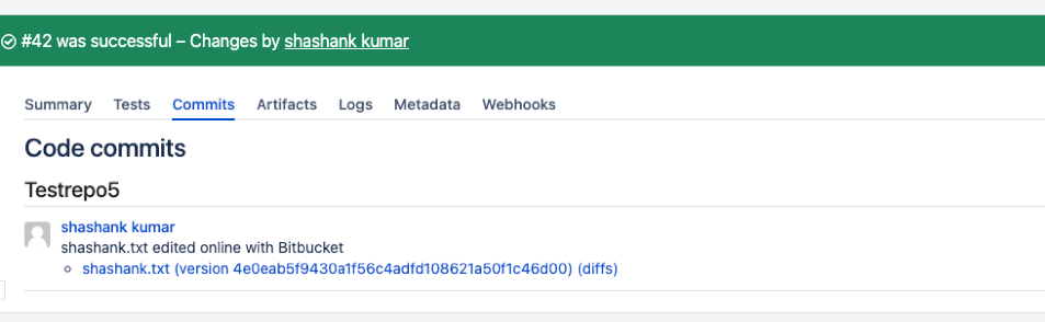

For your second query I think this information can be seen under Commits tag, it would give you the information about the repository for which the commit was made and then the build trigerred, something like below

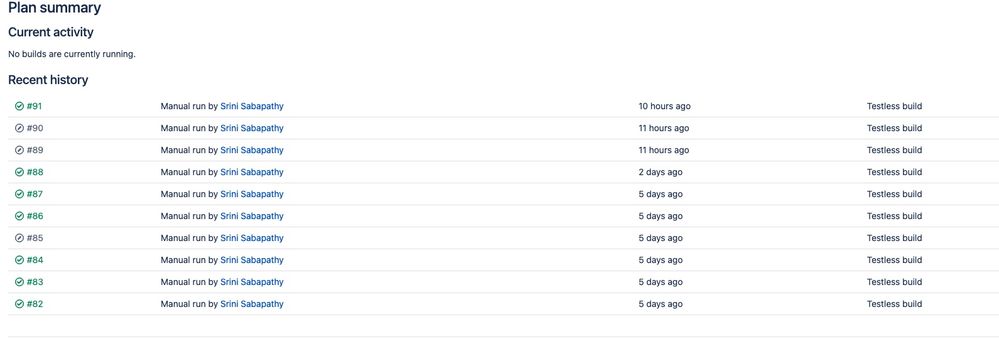

The concern I raised was from operation aspect. Let me try explaining,
So as per the design, we want to have a single generic plan to promote different business code repos. Which technically works.
But now, when Operations comes to the Build history page they only see, #1, #2 etc. And if they want to find out from the history page itself which repo has triggered, its not possible.
Which is why we either wanted to change the Build Number to have the "Repo name" prepend in front. And your first suggestion will not work as it can hold only Integer. But I was wondering the symbol "#" is coming is it hardcoded some or could customize it with some text.?
Regarding your second suggestion, we are already using it, but it again will not help us, as to see the details, one has to go inside the build, which is not possible as Operations team wont know which build to open.
Which is why we were thinking, either update the "#" with some text, or else, if we could customize the "Plan Summary Tab/Page" or "History tab/page" and add additional custom column.
Plan Summary
History
Regards
Srini
