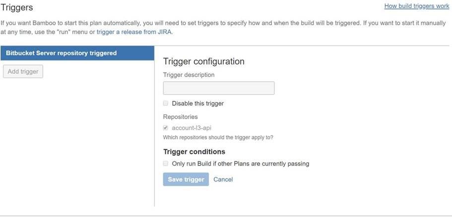

I would start investigating the trigger configuration in the integration build plan. If the repository is the same, you have a trigger configured to build your plan on new changes and you have that plan branch, the integration build plan will run the build.
Things to check:
  •  What is the Trigger configured?
  •  Are you using the Automatic branch management to create the branches in your integration build plan?
    If yes, the plan branches of that feature will be created and possibly triggered (depending on your trigger configuration)
  •  In case you have that feature branch as a plan branch in your integration build plan, should it really be there?
    Maybe your automatic branch configuration should be set with a regular expression to avoid creating plan branches that should not be there?
  • What are the conditions to trigger the integration build plan? (no new changes, scheduled trigger, remote trigger,...)

Below is the trigger configuration. Integration branch is the default branch configured to manage bamboo java-specs.
PFB, snippet of automatic branch management from planspec:
