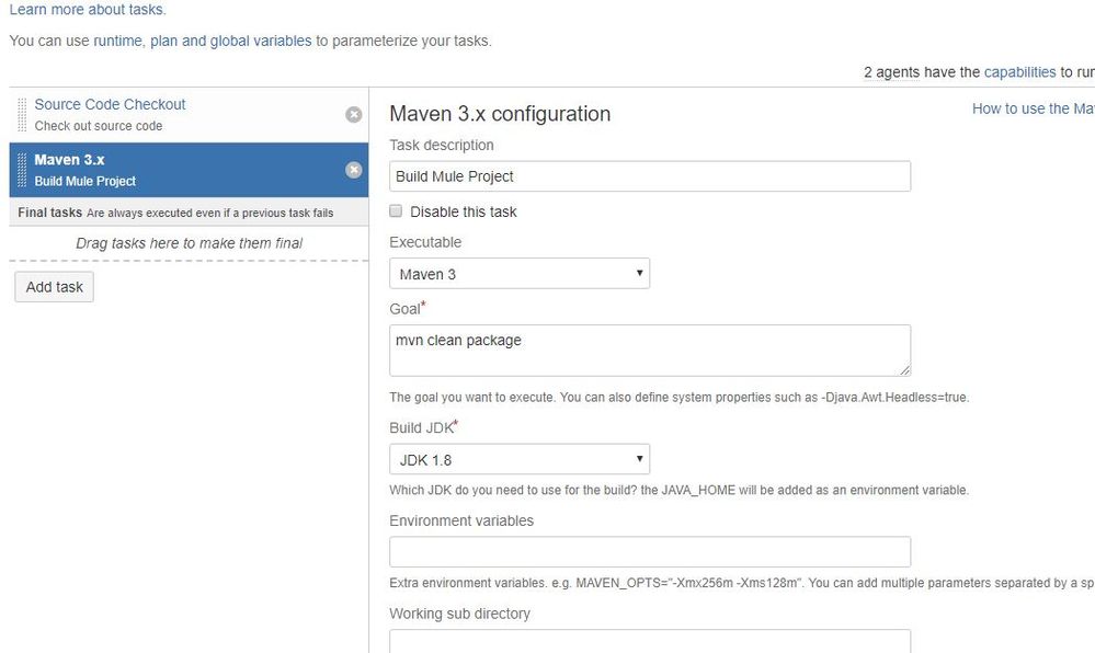

Hello Team,
I'm facing issue at Maven Build Task on Plan set up for Mule Project in bamboo. I have Maven set up in my local properly but i see below error logs when i try to build on bamboo. Maven is set on E: drive on my local and corresponding path is configured in environment variable
Error logs in Build :

Can someone  point out what else needs to be configured or reason for issue and how to resolvemaven_setup.JPG ?

From the build log and screen shot, this Maven task is configured to use the Java path /usr/lib/jvm/java-1.8.0-openjdk-1.8.0.111-1.b15.el7_2.x86_64/jre as JAVA_HOME.
Check if this path /usr/lib/jvm/java-1.8.0-openjdk-1.8.0.111-1.b15.el7_2.x86_64/jre exist in the machine hosting Bamboo.
If it does not exist, edit the JDK 1.8 Capability at Administration > Build Resources > Server Capabilities to use the valid path to Java 1.8

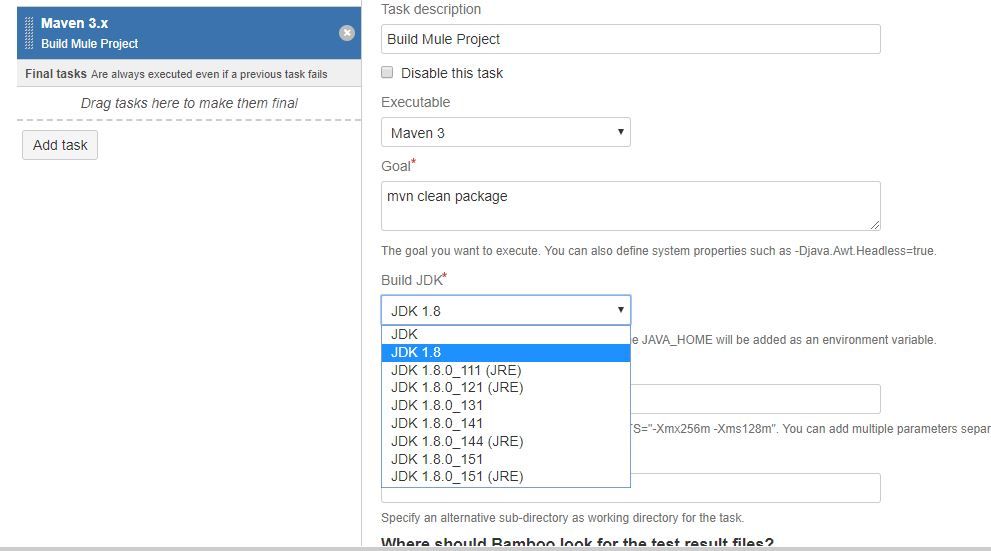

@Foong below is maven configuration on bamboo server

As you can see above java home on server is different from the path that is being referred in my build.
Can you please let me know the reason for this difference in configuration ?
Also i could see that latest JDK build is not getting reflected if i try to config manually.
PFB screenshot
Let me know your views on this.
Thanks in advance.

The path for "Build JDK" - JDK 1.8 have to be edited at Administration > Build Resources > Server Capabilities
Have you edited the JDK 1.8 capability at Administration > Build Resources > Server Capabilities ?
