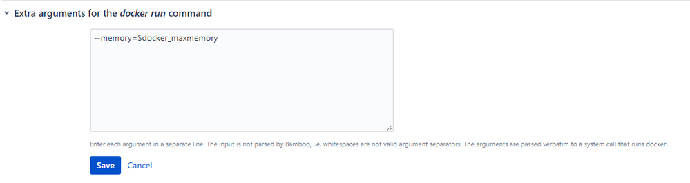

we are trying to limit the docker resource on agents that we use to run bamboo jobs, we have different agents (VM and EC2 instance) running ubuntu and these agents have different memory capacity and we have a environment variable in each agents that has maximum value that can be used by docker in that respective agent example docker_maxmemory=14436m (14GB). Now we are passing an extra  argument to docker run command from bamboo like this  "--memory $docker_maxmemory" here $docker_maxmemory is variable that has some value but bamboo pass it as string instead of variable and we are getting error like this "   invalid argument "$docker_maxmemory" for "-m, --memory" flag: invalid size: '$docker_maxmemory'    " Note : bamboo runs the job in docker container

As stated on the Docker configuration page:
"The input is not parsed by Bamboo"
Meaning you need to either add the value of the memory property manually or run the Docker task as a command line using a Script task in case you need a customised memory setting.
