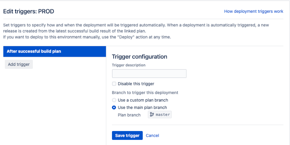

Hello Nagendra,
Thanks for the clarification, I think what you are looking can be done using the below configurations, let me know your view on this
1) You can setup a Deployment trigger for the Deployment environment which will activate once the build for any child module is completed successfully. Here I assume your particular module in a separate plan in Bamboo and the parent Build is another plan in Bamboo, correct my understanding if it's wrong.
Here The trigger can only be applied the plan which is linked to the Deployment Project ( the one which you want to deploy ), you cannot check the conditions of any other plan here.

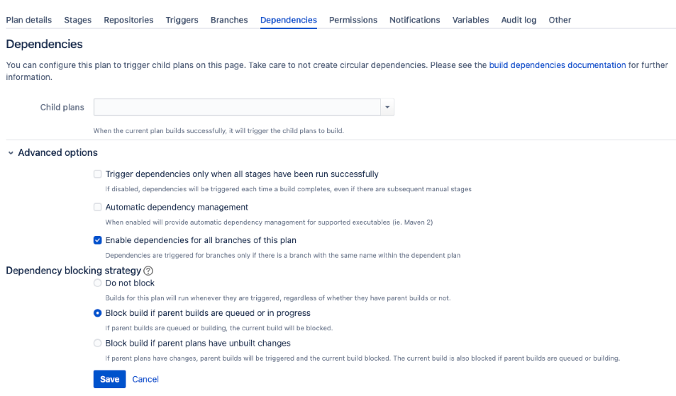

2) Now Inside Build plans, you can create a dependency for the main plan and create child plans, which means when the main plan is succesfull build, it'll run the child plans and if it's successful then the deployment trigger would get activated, refer below
Read more about it at https://confluence.atlassian.com/bamboo/setting-up-plan-build-dependencies-289276887.html
Let me know if this helps
