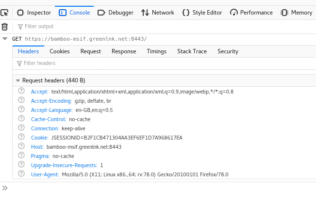

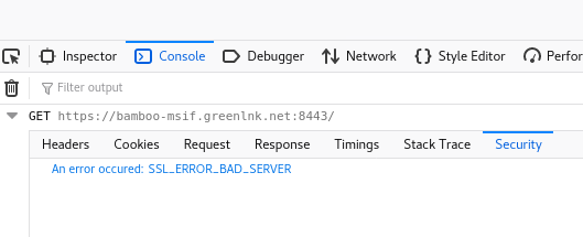

Could you share the error please?
web console log using developer tools ?
The above are from the 'Firefox' developer tools. Other than the above, the other tabs didn't contain any information of note or were empty.
