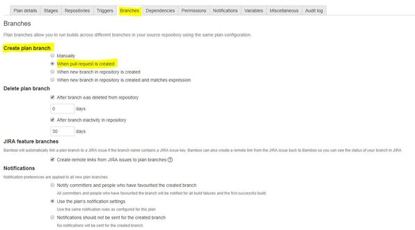

Are you making use of plan branches within your build plan?  Are they created manually? or do you have automatic branch creation when either a pull request or branch is created?
If you are unfamiliar with that I'm referring to here's a screenshot of that configuration within a build plan:
PlanBranchConfig.JPGAny more information you can provide would be really helpful.

Our environment is Linux Centos 7. Yes we do use plan branches exactly as in your image. We also configured a trigger (BitBucket server repository trigged).
