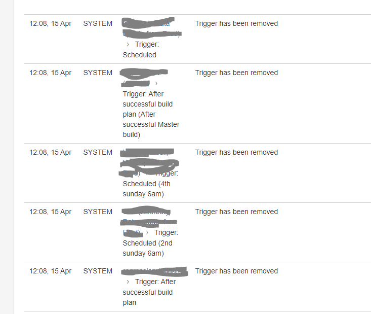

Does anybody know why the Trigger I set are being removed by the System?
Joel Enriquez
April 21, 2020
I have set scheduled triggers on my deployment project, however every month(seems like a random day)  it seems the triggers are being removed
After checking the Audit logs
The Triggers are being removed by the SYSTEM

Hi @Joel Enriquez,
That's really weird. Two hints here.
  1. If you open <Bamboo home directory>/logs/atlassian-bamboo.log, so your Bamboo Server log and grep for either "Trigger has been removed"or anything with "trigger" or "removed", can you match that with an error or an exception? If so, you might want to google for this error / exception and see where it points you to. Possibly that guides a way to solve this issue out.
  2. Since the origin of this "trigger removal" is called out to be SYSTEM, if you check your system logs for the dates and times of the Audit log, what does that tell you?
As the incidence is seemingly SYSTEM triggered, I would not expect you to find a lot per step (1) from above. Even though, it's a chance and thus worth trying.
Finding something in the system logs, I'd regard as much more realistic. And as root of this issue, I could just think of any process on your Bamboo host that, for whatever reason, provokes that accidentially.
Another viable question is always this: Since when do you see this happeneing and what you made just before the first time that you saw it? That might have been some Bamboo-, system- or possibly network-wise change and it might get you more ideas of what to look into.
Hope that I could be of some help. For any further assistance that you'd like, merely get back to your Community per this thread.
Thanks a lot, Gerhard
