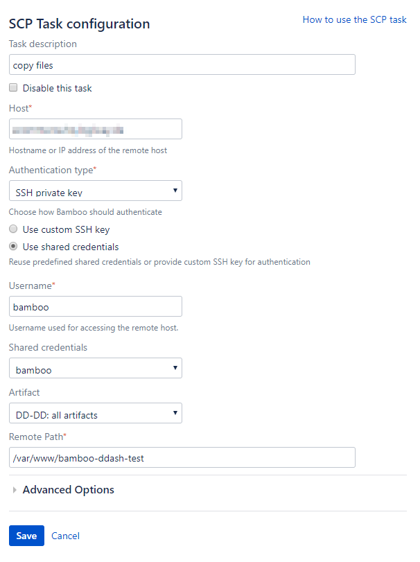

The task config looks like this:
I installed Bamboo on my Windows 10 machine for testing purposes. I didn't install any extra software so far, outside from Bamboo and adding JAVA_HOME to my PATH to make it run in the first place.

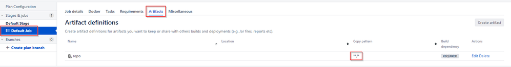

The error cause seemed to be, that no artifact was configured in my Build plan -> Default Job.
I added an artifact simply with the pattern "**/*", which clones all files from the working directory, except CVS folders by default.
Afterwards I got another error "Unable to download artifact Shared artifact: ..."
Browsing the forum for this error, it turned out changing (or adding) artifacts after configuring your deployment job can destroy the job and you just have to reconfigure the whole project from scratch.
I did that and now everything is working like a charm.
