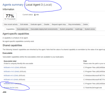

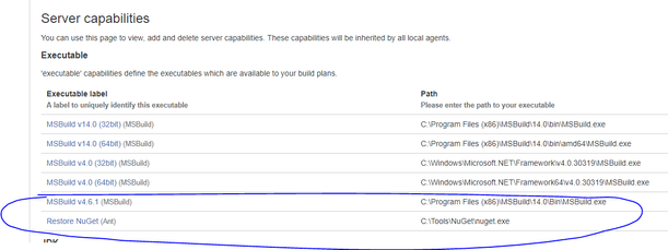

1) I setup a Server Capability for MSBuild v4.6.1, with the MSBuild.exe:
2) I have 3 local agents that can run that Server Capability:
3) I setup a Task to use this MSBuild v4.6.1

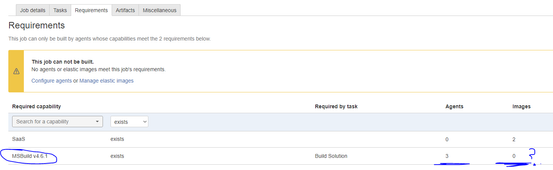

4) I add the Requirement to my Job and I get an error that there are no
If I start searching around, it takes me in one big circle.
Why is it doing this? Where is the missing bit to make this work?

The local agent have MSBuild v4.6.1 capability but does not have SaaS capability.
The Images number is referring to Elastic agent. Your current elastic image or agent does not have any MSBuild v4.6.1 capability.
You have to add SaaS capability to local or remote agents
or add MSBuild v4.6.1 capability to elastic image agents

We have MSBuild.exe on our elastic image. But it still says "No elastic image configurations have this capability" under Elastic Image configurations.
How do I tell Bamboo to use an elastic image for this capability?
Jeremy Roelfs
June 21, 2018
In order to add a capability to the elastic agent...
- At your main Bamboo interface.
- Click "Image configurations" on the left
- Click on the elastic image you wish to add to...
- Next you will see a little "Add capability" in blue on the left of the title
- It will then take you down to the bottom of the page where you can add the new capability
There are 3 different places to "add capability" and they all look the same. This route will set up a capability specifically on that elastic image for your MSBuild task to use.
