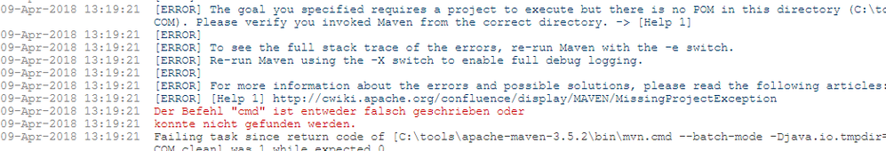

I have a windows build agent which is configure to run maven builds. When I started running it as service , build are failing continuously with below error.
Agent log on user is not Local System and ENV variables are correctly configured. Can someone help me to solve this issue.
PS: when agent is running as non service, builds are success.

Hi Akhil,
I believe the English translation to the error is this:
<cmd> is not recognized as an internal or external command
We see this problem often, and it's often related to the SYSTEM path not working when using the agent as a Windows Service which is outlined in the below knowledge base article:
 Hope that helps.
