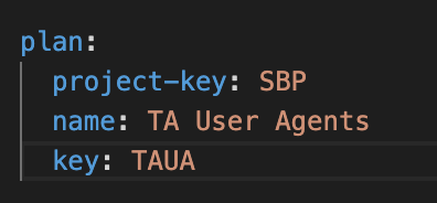

Dorian Brim
April 20, 2020
Apologies, but I actually did have a plan key specified on a new line, when pasting the code in I had to insert all the new lines manually and missed this one, but here is what I have

Alexey Chystoprudov
April 21, 2020
It looks like parser can't see new line. Can you try to change order of tags and put key after project-key for example. Just to be sure it's definitely new line

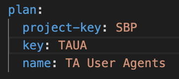

Dorian Brim
April 22, 2020
I put the key tag below the project-key tag and I'm still getting the error. I added an attachment of part of the error and what I changed.Screen Shot 2020-04-22 at 10.53.57 AM.pngScreen Shot 2020-04-22 at 10.54.13 AM.png
Alexey Chystoprudov
April 22, 2020
What's your Bamboo version?
