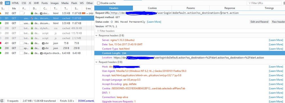

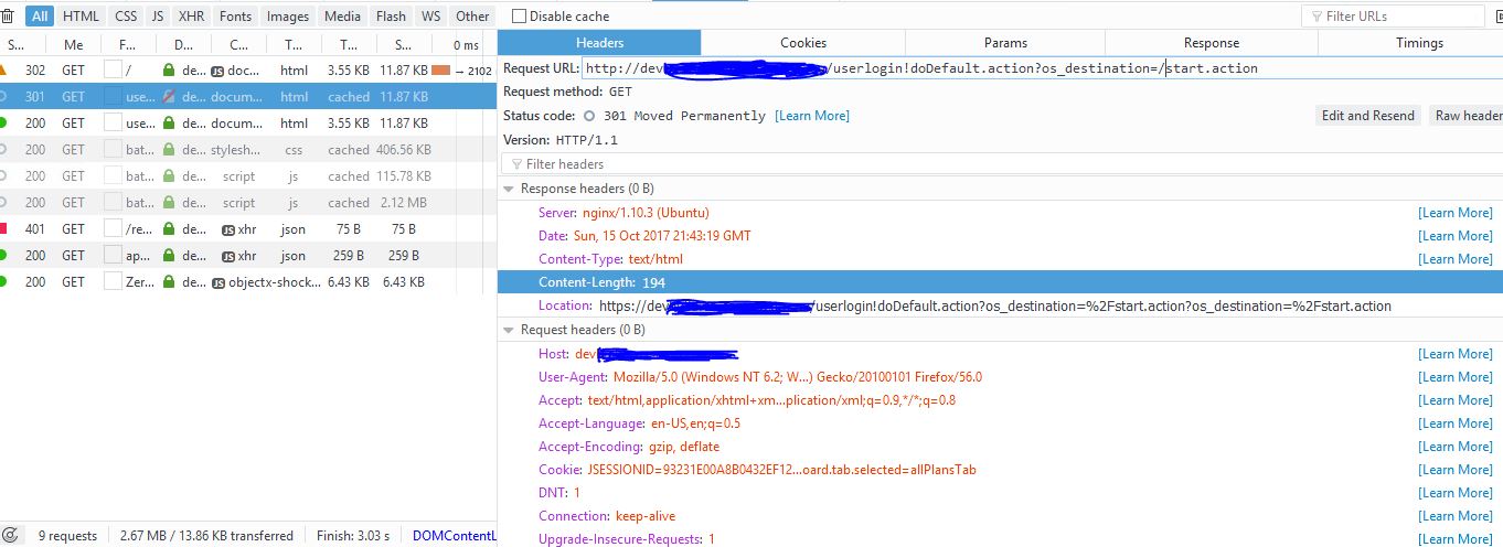

I installed bamboo in a test environment, when i visit https://dev.xxx.com, it is redirected to https://dev.xxx.com/userlogin!doDefault.action?os_destination=%2Fstart.action?os_destination=%2Fstart.action
os_destination=%2Fstart.action appears twice in the url, so after i login i got an error page.
I used Nginx as a HTTPS reverse proxy. And http between Nginx and Bamboo Tomcat.

Looks like you need to add the proxyName and proxyPort parameters to the server.xml file as described in Securing Bamboo behind nginx using SSL.
