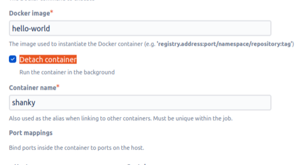

When you select Detach container option in the Docker Task, the container will run in the background, see my example below

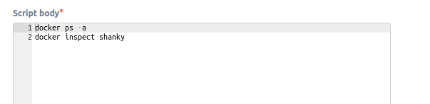

1. Docker Task

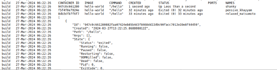

2. Now in my Script task I am inspecting this running container with name shanky and I can see the results which means the container is running within the script task and will be killed when the Job finishes.
Build Logs
You can see above the container shanky is in running status when the script task is getting executed.
