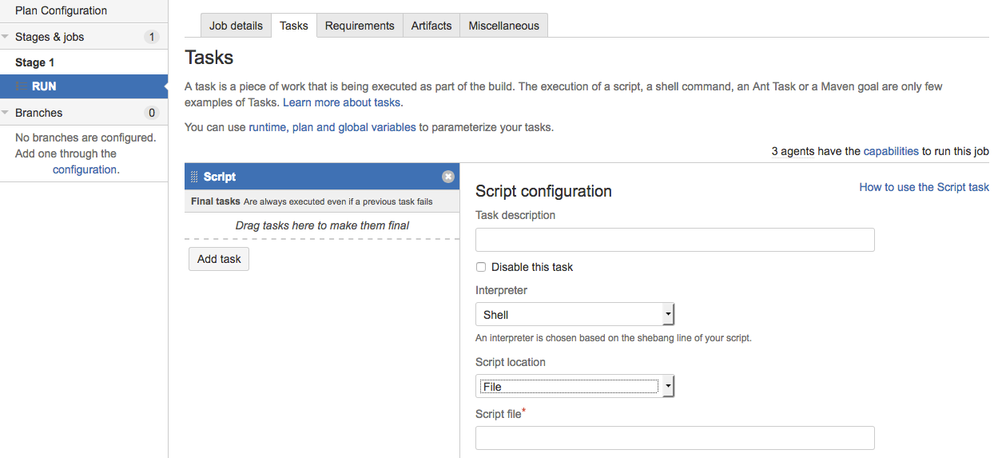

How about sharing the screenshot? and the Bamboo Version you are using?
Also, share the commands that you are using.
My Screen Shot:

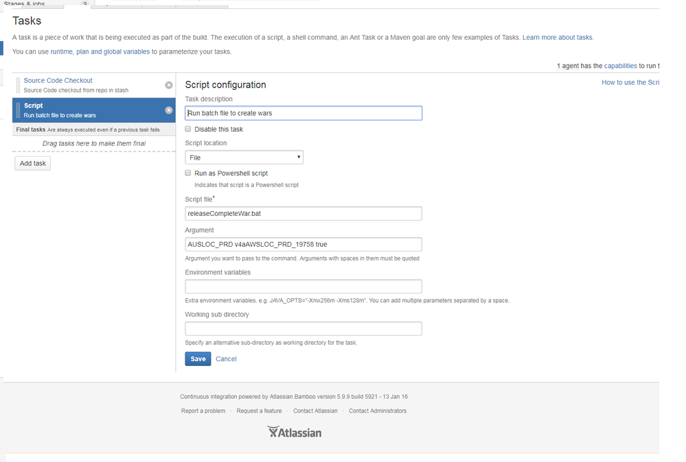

Loveleen Sidhu
February 11, 2018
Hi Robhit,
this is the task page I see on bamboo. Solved this one by installing ant on the server which was actually missing. But I cant see any interpreter dropdown option on my task page.
Thanks,
Loveleen
